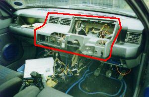

Fig. 1: Centre fascia
Fig. 2: Heater control cables
In replacing the heater matrix, I went through about the same stages as Gary did. However, a significant difference is present. Gary removed the complete fascia while I didn't. I only removed the centre fascia as indicated in Fig. 1. Most probably when designing the fascia, Renault did not intend to have this part removed. Still, it is possible, and it offers distinct advantages. The most important advantage is that of saving time. By removing the centre fascia, the rest of the fascia only has to be unclipped - not removed. Additionally all the cable work attached to the fascia's back can be left in place. This avoids all the work of unclipping these cables and of replacing them. Of course there also is a disadvantage. You may be left with visible damage to your facia. Because of this you will have to work rather careful at some stages, but for me this was outweighed by the time spared. I worked on it for about two afternoons from 13h00 to 17h00, totalling in about 8 hours of work. A fast calculation will make you think this saved me only 2 hours over Gary, but Gary already had the opportunity of 5 hours of practise on the first (and failed) attempt. I started the job completely unknowing, even without a copy of Haynes. Please take into consideration all advantages and disadvantages and decide for your self in what way you will replace your heater matrix.

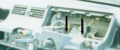

7. Undo the cables running from the heater controls to the heater box. The two cables are both attached to the box and to a lever, see Fig. 2

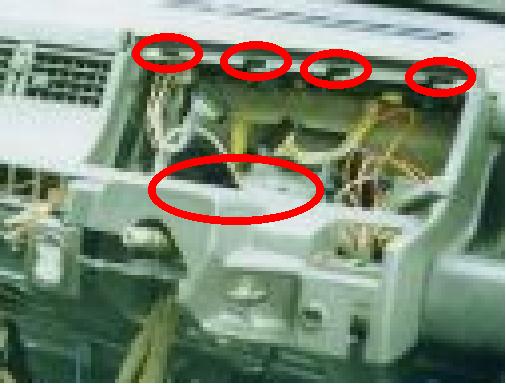

8. Remove the centre fascia. It is attached to the rest of the fascia in a rails at both sides. Working your way up, you lift the centre fascia from this rails using a small screwdriver. A large part of this lifting can be done inside the fascia, however the last part has to be done on the outside. This has to be done very carefully to avoid damaging the fascia. Having lifted the sides, one will notice that the centre fascia is still stuck at the top and just above the steering column. These locations are illustrated in Fig. 3. Connections at these locations have to be broken, however when done carefully, no damage is visible after finishing the job. Finally, the centre fascia can be lifted. One will notice metal clips just above the centre ventilation holes, be careful not to bend them.

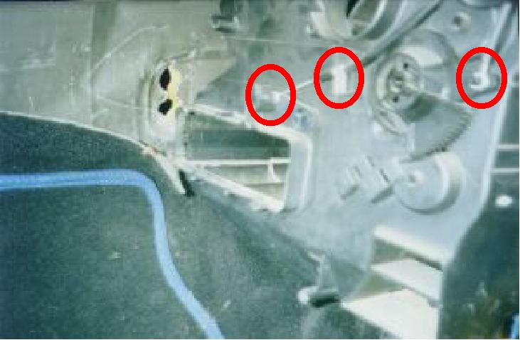

9. Remove the (two) screws that connect the fascia to the steering column, see Fig. 4.
