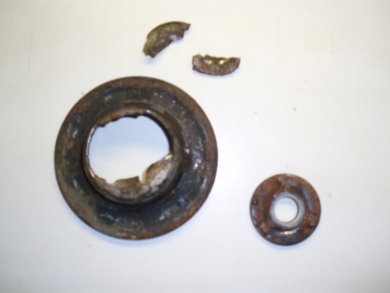

could be any of it, it all fails. rubber dohnut, bearins seize/come aprt - top hats break through
http://i15.photobucket.com/albums/a3...s/P9120049.jpg
