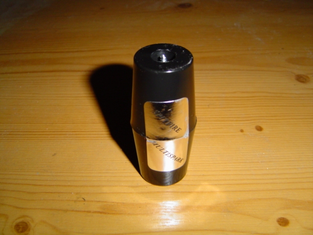

You've seen the spiel.... turns one spark into 5 at the spark plug, promoting a cleaner burn....

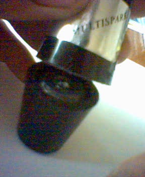

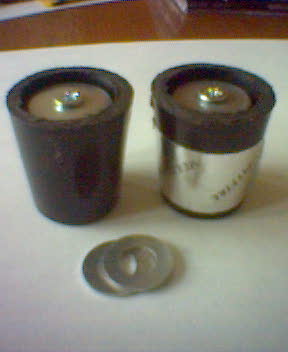

well, *someone* cut one open and had a look at what it looks like inside.....
2 screws (crosshead)
2 steel washers.
2 aluminium washers.
2 plastic cups.
+ a small amount of epoxy to glue the 2 cups together
The arrangement in the unit means that the two steel washers are held to the plastic by the two screws. In between the gap are the two aluminium washers.
How does that work then?
That's a good question.

The inner secret is revealed
https://www.rtoc.org/articles/i/autof...14_122x150.jpg
Not very exciting, just some washers.
